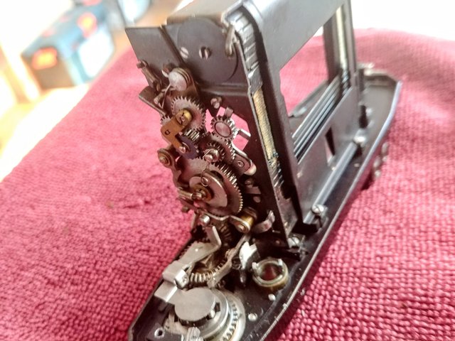

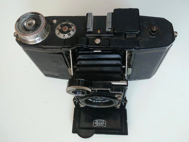

« Reply #470 on: August 02, 2020, 12:48:42 AM »
I've been interested in Zeiss Ikon Super Nettels for the past few months, but they go for $400-$800. So, no way. There was a nice looking one a while back for around $380. I was tempted but I try not to spend more than $120 on a camera, preferably no more than $40. So when I went browsing again for them one showed up in my search for $120 on Bonanza, from a guy in the UK I've bought from before when he was on Etsy. So why was it so cheap? The shutter didn't work. It just so happened I recently watched a video on YouTube where a guy fixed a stuck shutter on a Super Nettel by spraying a load of lithium grease on the gears. It worked... But more importantly for me, he showed how incredibly simple it was to disassemble the camera. Oh, and it was missing the rewind knob.
After a sojourn in LA, the camera arrived today.
Just loosen four screws on the bottom, four screws on the front holding the lens/bellows assembly to the body, and two screws holding the housing for the film canister and take-up reel and you'e ready to clean up the shutter gears. I used lighter fluid, not lithium grease.
The lighter fluid loosened things up as expected. The fast speeds -- 1000, 500, 200, 100 -- worked great. On the slower speeds, the first curtain would begin to open as you cocked the shutter, then the second curtain would close rather slowly when you fired it. Not sure what's going on so will need to do a little research. Or I could just try spraying lithium grease on it.
When I put it back together, even the fast speeds were hanging up. Hmmm. I noticed that someone jerryrigged a little wire for a missing screw. You can see it at the upper right of the last pic. I removed it (it wasn't doing anything as another screw was still in place holding that little disc which itself doesn't seem to be doing anything -- it doesn't move (famous last words).
Anyway, put it back together for now to test the fast speeds. The shutter ribbons look in great shape. The rangefinder seems to be in proper adjustment. Lens looks great. The aperture blades are clean. The lens focus was very stiff at first but working it a bit it's fine now.
 EDIT: oh, I see that disc holds the spindle for the second curtain. Maybe I should look for a screw
« Last Edit: August 02, 2020, 01:36:03 PM by hookstrapped »

« Reply #471 on: August 02, 2020, 02:46:00 PM »
I'm never a fan of spraying stuff around. The overspray always goes where you don't want it to. I like using a syringe with sewing machine oil much better.
Re: I just made/fixed ...
« Reply #472 on: August 02, 2020, 08:21:36 PM »
Well, I went scavenging through my parts camera box and pulled out some candidate screws. Found one -- from the film retaining springy piece of metal in the take-up reel chamber of a Kiev 4A. Round head instead of flat head but the perfect thread and (very short) screw length.
I also squirted it with lighter fluid again and the slow speeds work (well, 50 and 25) and the fast speeds are much snappier. Dunno why I can't even turn the speed selector to 10, 5, or B but I'm not going to sweat it. The additional slow speed mechanism kicks in at 50 so it's not that.
Before I cleaned it again, when I tested it and cocked the shutter, it squeaked. So I guess it needs oil. I have sewing machine oil but am not sure where to apply it...
« Reply #473 on: August 02, 2020, 09:07:27 PM »
Usually, the oil is only applied very sparingly to the pivots.
Too much oil will slow things down.
Grease is only useful for regions of high friction, high pressures, low speeds or where oil would drip everywhere.
Most camera mechanisms I've seen so far except for the focusing helix don't need it. And even then the focus needs an insanely small amount.
I tried lithium grease on some things but had to remove it because it thickened with time and made things hard to move (I put some on the focusing ring of a lens).

« Reply #481 on: September 30, 2020, 05:07:24 PM »
This is an update on my Super Nettel. After getting the shutter to fire by using naptha in the mechanisms, one of the silk ribbons holding the lateral shutter slats broke. Rather than sending it to the Contax guy (its shutter is the same as in a Contax I) who insists on rebuilding cameras completely whether they need it or not and charging accordingly, and has a 10 year waiting list (his email was quite amusing and that was the punch line), I sent it to Oleg in Russia. Got it repaired quickly at a reasonable price. All the shutter speeds working well. Took my first pics with it the past couple days and I really like the results -- particularly the combination of sharpness and the way it renders out of focus areas, and the transition between the two. Anyway, like the look of the lens, a f3.5 Tessar.
More pics
http://www.filmwasters.com/forum/index.php?topic=10142.0
« Last Edit: October 09, 2020, 11:55:20 AM by hookstrapped »

« Reply #484 on: September 30, 2020, 09:30:07 PM »
It's hard to find someone with the experience and willingness to replace those ribbons. There are some DIY instructions floating around that I looked at but... Nah.
Though the Contax I, II, and IIa shutters are somewhat different, they're the same basic design. I think Oleg's experience repairing Kiev rangefinders has made him the go to guy for the metal slat shutters. He said he never worked on a Super Nettel but I sent him pics and my understanding that it's the same as a Contax I (that he lists on his site as a camera he works on). Anyway, great experience. He also replaced the missing rewind knob before I even asked him about it, all for the CLA price.
