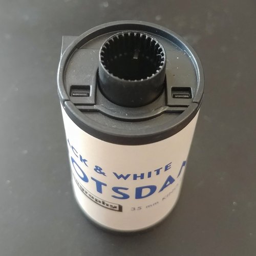

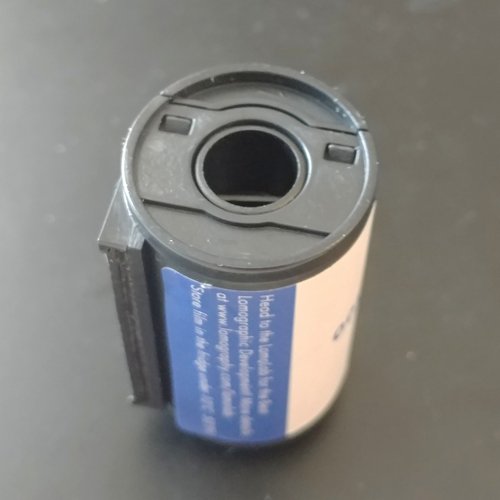

I have this roll of 35mm Lomo Potsdam film to develop, and I was wondering if there's anything I should know before I try to bust it open with a can opener...
I've never come across this type of cartridge before. The caps don't have much of a lip for a can opener to grab onto. They almost look like they're hinged...

I've never seen these before either, but I notice that there are two tabs in each end of the cartridge. Maybe it will pop open if you push them with a small screwdriver? Just remember to do it in the dark.  ;)

I have heard about these but never had to open one.  I think you need to take the label off, it splits on a seam down the side.  The problem is I think that seam is where it's fused together.  I don't think they are easy to get into, may need to put a chain saw in your changing bag just in case.

Well that's a new one.
A film retriever would be the best option but without one I'm sure it's going to need a bit of surgery (and hopefully not on the fingers).
I often use a thin guitar pick to open the snaps on electronic devices.
Hopefully they used some brittle plastic that can just break open.
Though after looking at it some more, I would probably cut the label first and then use a screwdriver and use the spindle as a lever to pop it open (use the lip on the top). A wide blade and a twisting motion should do the trick.

All good suggestions. I emailed Michael Raso at FPP and he got back to me right away, passing along the illustrated Lomo instructions. As I replied to Michael
Thanks. Pressing two screwdrivers against two little tabs in the dark. Brilliant design :rolleyeyes:
I came up with an alternate method. I jammed a screwdriver into the crack between the bottom lid and the canister and tore off the lid.
Had to battle the dreaded film sweats (it's humid today) but got it done. Thanks for your quick reply. And please tell Lomo for me, "Hahaha! No really."

Back to the original weird Lomo plastic cassette... For the second roll I reluctantly followed Satish's suggestion (a sure sign of desperation) of simply leaving a leader out and feeding it into the Patterson reel and just cranking it onto the reel directly from the closed cassette. It worked! I'm now a convert to the Indofunk(TM) method.
