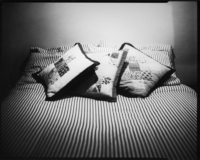

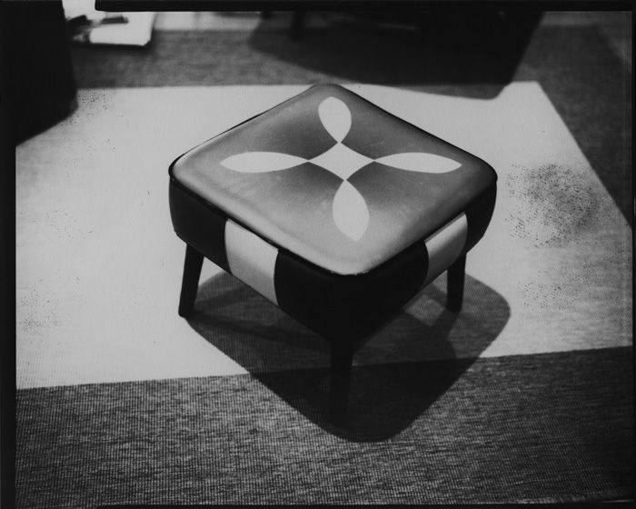

Re: Harman Direct Positive Images
« Reply #16 on: February 28, 2013, 09:25:33 PM »
Joe : Thank You for nice tips
my examples here :
