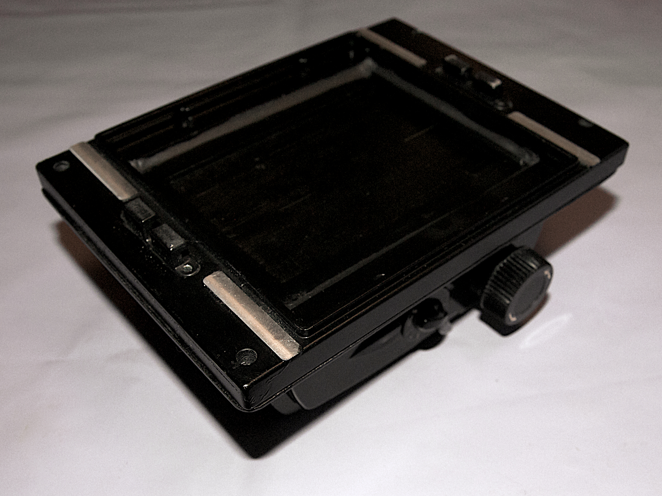

I ended up taking an easier route, opting to go medium format instead. Grafting a Polaroid 600SE back adapter to the 110A, making it almost as versatile as anything with a Graflok back, only slightly smaller. I can now mount just about anything up to 6x9 in 120/220 with the right adapter, not to mention Polaroid backs and even 4x5 (though not covering the frame completely).
The hardest part was manufacturing the adapter plate. I made one that both functions as a mount for the adapter, but is also the side wall of the camera (where the end has been chopped off). The film plane has as a result of the plate and the 600SE adapter been moved back an inch or so, so the end stop for the lens has been moved back correspondingly.

Polaroid 110A w/600SE back adapter - rear view with CB103 back attached
Polaroid 110A w/600SE back adapter - rear view 600SE adapter

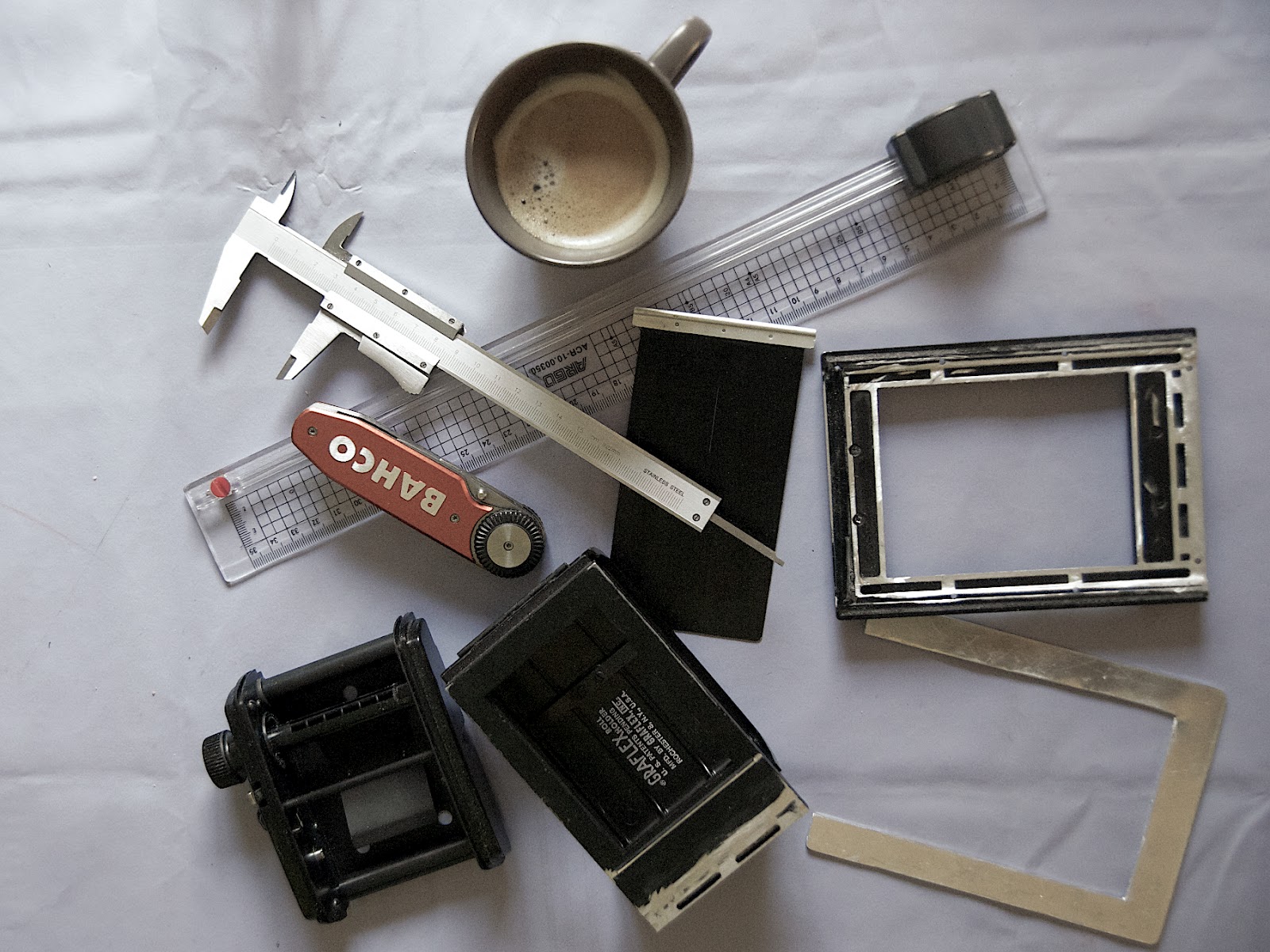

Regarding the Polaroid. Part 2, a 120 roll film back:
Having used the camera with Polaroid CB-103 backs I thought it would be good to see if it could perform well with 120 film too. The main reason for not just grafting the CB-103 straight into the camera in the first place, was indeed to keep other options open.
Criteria: Cheap, functional and 6x9. That means both the ready to fit backs for the 600SE (Mamiya S-shaped backs) and the RB67 were out. The former too big, obscuring the viewfinder. The latter not up to 6x9. And both expensive.
Solution: DIY it.
Parts: Graflex 23 back, 600SE/Miniportrait adapter plate, 1.5mm sheet aluminium, paint, glue, flocking material, machine screws.
Obviously the back and adapter don´t fit. No mounting fittings common, film plane off by 3.2mm. To solve the latter I ground out a trough in the plate 3.2mm deep with a Dremel. A horrible job, not worthy of repeating. To solve the former I cut out a skirt to go around three edges of the roll film back, recessed the necessary 3.2mm from the mount face. Glued the two together, lined the back with skirt up with plate, drilled mounting holes through the skirt and screwed them together.
Parts half way through, some tools and some nerve calming Café Longo.
The 600SE mounting plate, or adapter. A 3.2mm deep trough has been ground out from the right edge and just beyond the left edge of the light opening. Width as for the Graflex back, not much more than the breadth of the opening top to bottom. As luck would have it, lining up the Graflex right edge (as seen from the rear) with the plate´s right edge meant they were aligned left to right.
Lip glued to the Graflex, allowing the back to fit into the depression in the mounting plate. Then screwed to the mount. Flocked all round
As seen from the mount face
Mounted on the camera
