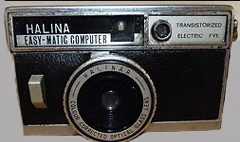

Hi there
New here tend to ask daft questions, love daft replies
Just found the above but have no idea what  "transistorized electric eye " is
In fact there seems to be very little on this camera that i can find
thanks
wendy

The electric eye is just for auto exposure. The circuit probably has a bc107 in it somewhere to justify the 'transistorised' tag.
The camera takes 126 film. Not sure you can get it anymore.

I assume this would be done by shutter speed ? or was it selected apertures must have been rudimentry if it was

usually, these systems vary the shutter speed using small electromagnets. It probably releases the front shutter and uses the transistor to time how long before releasing the back shutter.
Don't know. If there's no manual aperture then I would think it's got a combined aperture/shutter mechanism - the shutter opens a variable amount so alters the aperture. If it is working you could probably tell just by watching the shutter as you fire it while pointing it towards and then away from the light. You should see a difference.

Would that not give an odd negative?
You mean the shutter opening a variable amount?
No. The shutter is in the lens. It's like having the aperture at some setting smaller than maximum aperture. It just makes things darker.

Ah I was thinking a simple leaf shutter due to the cheapness of the camera and didnt really consider a multi leaf shutter, Its a thought

It may be simple. Some of them are just two parts cut as a V that overlap. It's the fact it's in the lens that means it won't have any strange effects.
