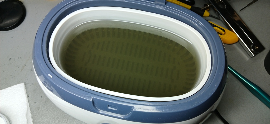

An ultrasonic cleaner is also a good idea - makes cleaning the helicals a lot easier though IPA and a toothbrush works. I fill mine with IPA which is NOT recommended as IPA can ignite of it gets hot and it will if you run the cleaner for too long. But it dissolves the old grease very quickly.

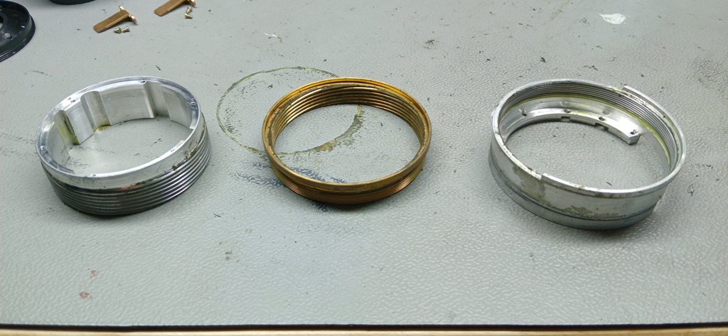

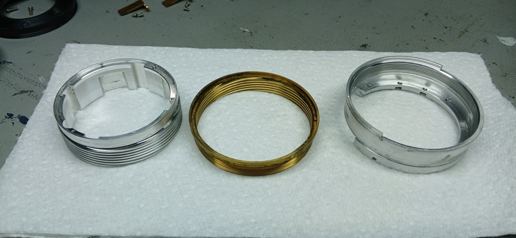

  • Posts: 2,232
Re: Tools for lens servicing?
« Reply #7 on: January 28, 2026, 03:49:15 PM »
An ultrasonic cleaner sounds great, but that may be getting ahead of myself!
I've just been cleaning the focus of a lens today. The ultrasonic cleaner makes it so much easier and no mess. Doesn't need to be an expensive one.

BTW, Peter, is your ultrasonic cleaner a model that uses a motor or an actual driver?
I have a small one that uses a motor and it's not very good... it dates back to the 80's.
  • Posts: 2,232
« Reply #11 on: January 29, 2026, 04:29:45 PM »
It uses an ultrasonic driver. Not sure what frequency it is. I think they're usually around 45KHz. These are usually sold for cleaning jewellery and such like.
